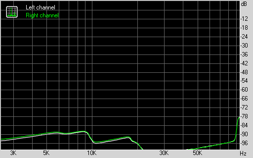

| Frequency response (from 40 Hz to 15 kHz), dB | +0.02, -0.13 |
Excellent |

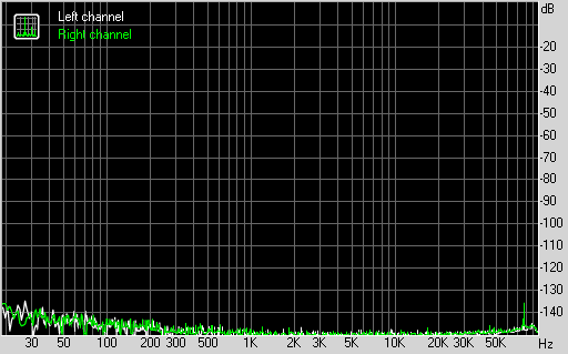

| Noise level, dB (A) | -115.0 |
Excellent |
| Dynamic range, dB (A) | 115.2 |
Excellent |

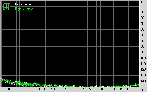

| THD, % | 0.0009 |
Excellent |
| THD + Noise, dB (A) | -97.4 |
Excellent |

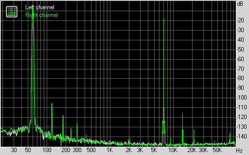

| IMD + Noise, % | 0.0017 |
Excellent |
| Stereo crosstalk, dB | -111.7 |
Excellent |
| IMD at 10 kHz, % | 0.0021 |
Excellent |

| From 20 Hz to 20 kHz, dB | -0.24, +0.02 |
| From 40 Hz to 15 kHz, dB | -0.13, +0.02 |

| THD, % | +0.0009 |
+0.0010 |
| THD + Noise, % | +0.0010 |
+0.0012 |
| THD + Noise (A-weighted), % | +0.0012 |
+0.0014 |

| IMD + Noise, % | +0.0017 |
+0.0017 |
| IMD + Noise (A-weighted), % | +0.0014 |
+0.0014 |

| IMD + Noise at 5000 Hz, | 0.0019 |
0.0022 |
| IMD + Noise at 10000 Hz, | 0.0019 |
0.0022 |
| IMD + Noise at 15000 Hz, | 0.0019 |
0.0022 |
