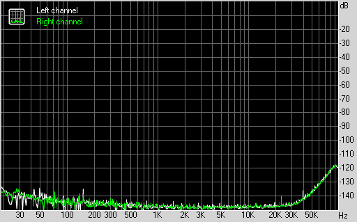

Frequency response
Spectrum graph
From 20 Hz to 20 kHz, dB
-0.36, +0.01
From 40 Hz to 15 kHz, dB
-0.11, +0.01
Noise level
Spectrum graph
Left
Right
RMS power, dB
-111.6
-111.7
RMS power (A-weighted), dB
-113.0
-113.2
Peak level, dB FS
-70.0
-70.8
DC offset, %
-0.0
+0.0

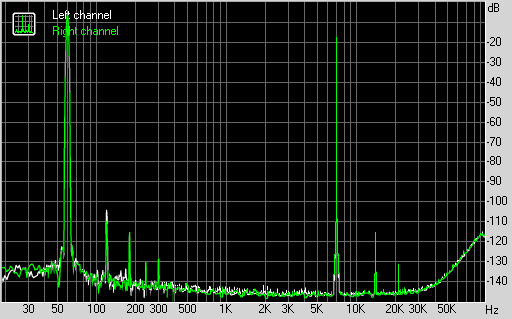

Intermodulation distortion
Spectrum graph
Left
Right
IMD + Noise, %
+0.0017
+0.0015
IMD + Noise (A-weighted), %
+0.0013
+0.0012

IMD (swept tones)
Spectrum graph
Left
Right
IMD + Noise at 5000 Hz,
0.0019
0.0019
IMD + Noise at 10000 Hz,
0.0019
0.0019
IMD + Noise at 15000 Hz,
0.0019
0.0019
